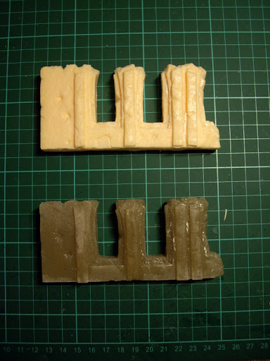

    Yes, i try to mold it in silicon rubber and then cast in resin.
    Smth like that (up-original wall of penopolystirol, down-resin casting copy)

    Quote Originally Posted by Davout View Post
    Great stuff, it would be a ton of fun to play with any of those pieces on the table top.
    If you are interested in Hirst Arts stuff I can give it a strong recommendation. You are correct, plaster is less strong then resin, but it's much easier to work with. I cast all my Hirst blocks using a plaster I find at Home Depot (a home store in the states) and it works great
    Thanks! Can you give me a link to this product (i'll try to find analogues in Russia).

    It is commonly called Plaster of Paris here in the US.
    I use dental plaster myself, which is Plaster of Paris with a little cement mix into it for added strength.
    This type of plaster is very hard to break.
    Dental plaster can be hard to find, but I have considered making it myself.
    You can add 10 to 20 percent cement to Plaster of Paris to get a very similar product.

    Quote Originally Posted by Tommygun View Post
    I use dental plaster myself, which is Plaster of Paris with a little cement mix into it for added straight.
    Well, it is perfect info! I'll try to mix it as soon as it possible) Tommygun, lot of thanks to you !!!
