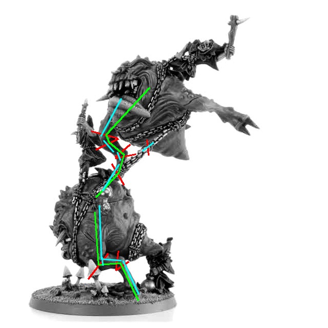

    I was bought a mangler at Xmas that was replaced due to flaws. I've had to sculpt and wedge a rock under it's foot to stop it sagging down. Still not got round to painting it and I'm glad I haven't as I suspect that the model will continue to reshape until it reaches a new equilibrium.
    I'm glad I'm not the only one having that problem, my solution was to position a night goblin archer under his foot to prop him up.
    Have you come up with a solution to stop the top squig bending backwards off the bottom one yet? My only solution so far is to store the model lying on its front so that gravity corrects the sagging.

    Have either of you reported this issue to GW?

    Given that it's a particular design flaw* on the model, I don't think the reports of 2 internet dudes / dudettes factor into the overall scheme of things. GW should be very aware that design has issues.
    Any big, heavy lump of resin held up by a thin spindly piece of resin will sag. The finecast / fw spincast resin just does it faster, as it's extremely responsive thermally.
    *: I don't personally consider this a flaw, BUT for a gaming piece sold to modellers who don't have the first idea on how to fix it, it is best considered one. It is fixable (to get the model looking just like the box) but it's an involved process involving cutting and accurate drilling.

    Surely it is a flaw, the one in GW Glasgow was the same, if the design and build of the model is compromised by the material it should not be manufactured in that material, next up gw branded chocolate fireguards and motorbike ashtrays!

    Edit: As for the Mangler, this pic shows where I'd cut, and where I'd reinforce. Probably 1.5 or 2mm rod, ideally stainless steel as it's less flexible than brass.
    http://www.winterdyne.co.uk/maz/imag...gler_chops.jpg
    Red lines are cuts, green lines, roughly where the main reinforcing rod should be. Teal lines are thinner pins for alignment or to prevent twisting around the metal core. It's an involved technique for sure, but it's not quite as crazy as resculpting that whole chain.
