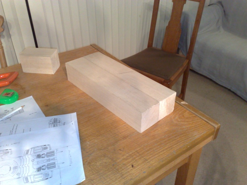

I paid a visit to the hobby store today, and bought the biggest piece of balsa wood they sold for the most reasonable sum of 11 english pounds (thats $22 for you american folks).
A little cutting later...
and a little glueing (can you guess what it is yet?)...
and we have the beginnings of my scratch built Orca dropship, designed to carry all those lovely death-dealing crisis suits into battle.

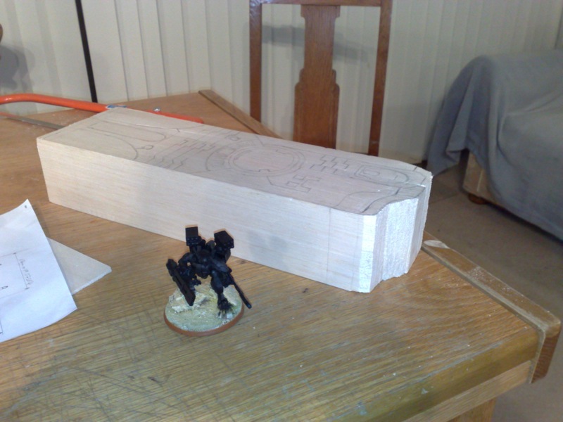

The final Orca will be built from balsa wood and plasticard. I have only templated the vertical axis so far, but it will look much better when I do the side profile.

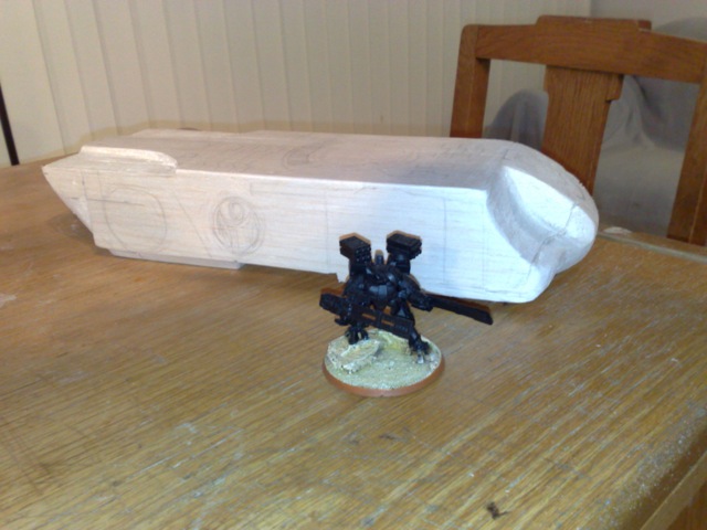

Minor updates on the Orca progress. Done all the cutting and shaping of the main body now, just need to seal the balsa with PVA and do some filling of the gaps/holes I have bashed in it/errors in sanding etc. . Was thinking of using milliput for this.
The hobby shop did have some actual 'Model filler', although I have not used this before and am not sure if its any good? Anyone have any recommendations?
Anyway, onto the pic:

Looking very nice, alot of work must have gone into just curring and sanding some of those areas.... unless you have power tools that is![]()
@verydarkshadow: Yes indeed, the details will be added with a combination of card, plasticard and greenstuff
@Pravis: No power tools used I'm afraid. I was worried about making to big a mistake with them! Just an afternoons worth of good old fashioned elbow grease . Balsa is actually pretty easy to work with if you have some rough grade sandpaper and a junior hacksaw![]()

My only comment is that the Orca seems to be suffering from "Rhino-Tardis" syndrome. It looks a trifle small, given that it is supposed to be capable of transporting most of your army. Or is this just my inability to grasp a sense of scale from the photo?
@Lucifer216: Well I was slightly worried about this myself, but I have scaled everything according to the plans. I could have made it bigger so I shall be annoyed if it ends up too small. Problem is, without a real one to measure against, I can never be sure.
Also, if you look at the pictures in imperial armour, all the units are pretty much crammed in there with the crisis suits hunched up and fire warriors sitting along the walls and stuff.
If anyone has access to an Orca, it would be useful to get a measurement from nose to tail to check![]()

Graham: you may find Milliput is a bit hard to use as a filler on Balsa - you get problems when trying to sand it smooth, because the balsa around your filler "plug" sands away quicker than the filler itself, so it gradually ends up standing prouder than it started out...
The old Humbrol Model Filler used to work better with balsa than it did on plastic kits, but I'm not sure that they still make it - indeed they may be completely defunct now.
Get your local model shop to recommend you something that is still available!
As to sealing the balsa: two thinnish coats of Sanding Sealer, with a light sand after each coat used to be the method.
Sanding Sealer is basically cellulose dope with a filler powder in it, and will fill the grain (and whatever filler you end up using) very nicely, giving a really fine finish after the last rub down with fine sandpaper. Being cellulose based, I would recommend leaving it a good 48 hours before putting any acrylic based paint on it though, or you might find your paint flakes off again! Once it's fully dry, it will take the usual primers etc very nicely.
johno
(who worked in a model shop for twenty years before switching to IT...)
